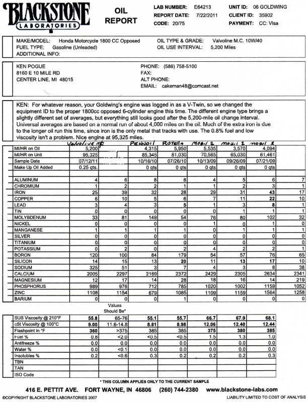

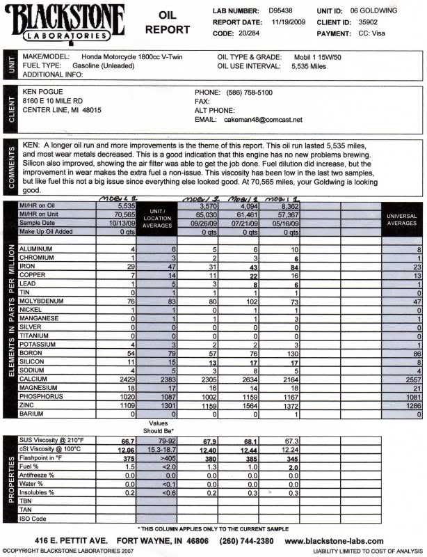

From past experience in aviation I believe that oil reports give you a great picture of whats happening inside your engine and allows you to make some informed decisions on how to care for it in the future. Just for background I have an 06 GoldWing with over 95,000 miles on it. I live in year round in Michigan and ride all year as long as the roads are clear. I know that the salt they put on the roads is bad for both cars & bikes but I just can't not ride for 3-4 months each year. Below are 50,000 miles of oil reports. I have used everything from the high & mighty Amsoil :lol: to everyday Dino oil. The oil has always been either 10W-40 or for the Mobil 1 15W-50. The thing that I noticed most from these reports is that ALL the oils viscosity break down with use. Keep in mind that you need to use the "Values Should Be" for the oil being sampled and you will see that the high & mighty Mobil 1 (report #1) and the Valvoline M/C (report #2)that I am currently using are both are less that what they should be. I have tried the synthetic oils for extended oil change intervals don't believe that it is beneficial. I think that it is best to use whatever flavor oil you like just change it & the filter often.

These charts make interesting reading Cakeman.
Do you do the same with the final drive oils?
939 Posts
Thanks for shareing these results.
Do you run Honda filters?
Have you ever cut different filters and had the lab run numbers on them and the job they are doing?

No I did not do the oil reports when I ran the Amsoil. I got swept up in the Amsoil hype when I first got the bike and bought a case of the stuff. I was not impressed and was happy when I used the last jug.
Kiwi
No I do not sample the final drive oil. I do change it often and I have a spare final drive from a trike take-off :lol:.
Section168
I ran the OEM filters at first but now I use either the Mobil M-108 or the WalMart ST6607 filters. I have in the past cut the filters open and looked for any shiny pieces but there was never any to amount to anything even when the transmission was acting up.

interesting reading,
I take it you did not use Mobil 1 m/c oil.....
do you plan to? just wonder if it may produce slightly different results....
939 Posts
Section 168
the link below did show pic's, now just wording (on my puter) where a person cut a filter
http://users.zoominternet.net/~capronem/Inside the ST7317.htm
I did on my FLSTC as some tecs I respect were telling me break in oil change at 500 miles not 1K as per manual.
I went overboard and changed filter at 500 and 1K cut the filter (hacker style in my vice) put on the gloves and got out all the bits with WD40 sprayed onto some coffee filters I cut up and taped together let um sit in alcohol to clean it all up and checked it out for curiosity. I am no scientist.
Few thumb nails at 500 1/4 thumbnail at 1k.
I did not on my Wing as I was on the road for its break in first oil change. In hind sight I should have kept the filter. Anyway I changed in Fargo then in AK and change between 3 and 3.5 K.
I think the numbers never lie and this post is spot on.
It would be interesting to see some filter science as well, but is probably splicing hairs after the break in and regular changes.
But it would be cool to know just how much work the filter is doing and if brand has much if any difference as no doubt the all get the job done.
S

No doubt some oils are "better" than others, at least in certain respects. But unless someone is maybe regularly racing their Wing -- that is, always running the engine to its limits, seems your summary line is right on -- use the oil that makes you feel good and change it/filter per Honda's recommendations.
