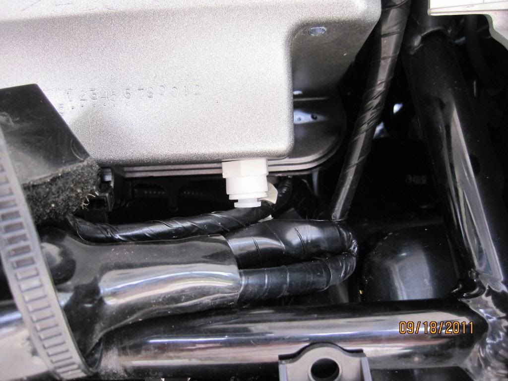

I don't know how many other people have this problem but on two occasions I have found water in the CB area. And I am talking about enough water to where the CB is floating. I have did my best at sealing everything off. But the other day while riding in the rain I noticed that I still have some water coming in from somewhere so I have came up with a drain.

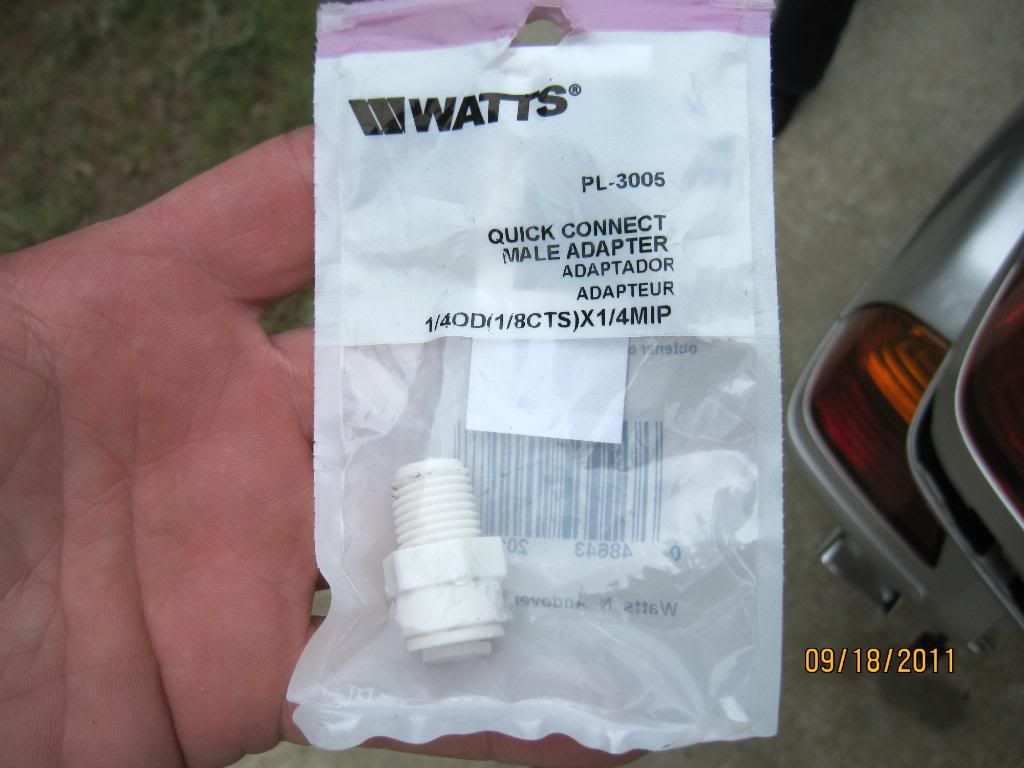

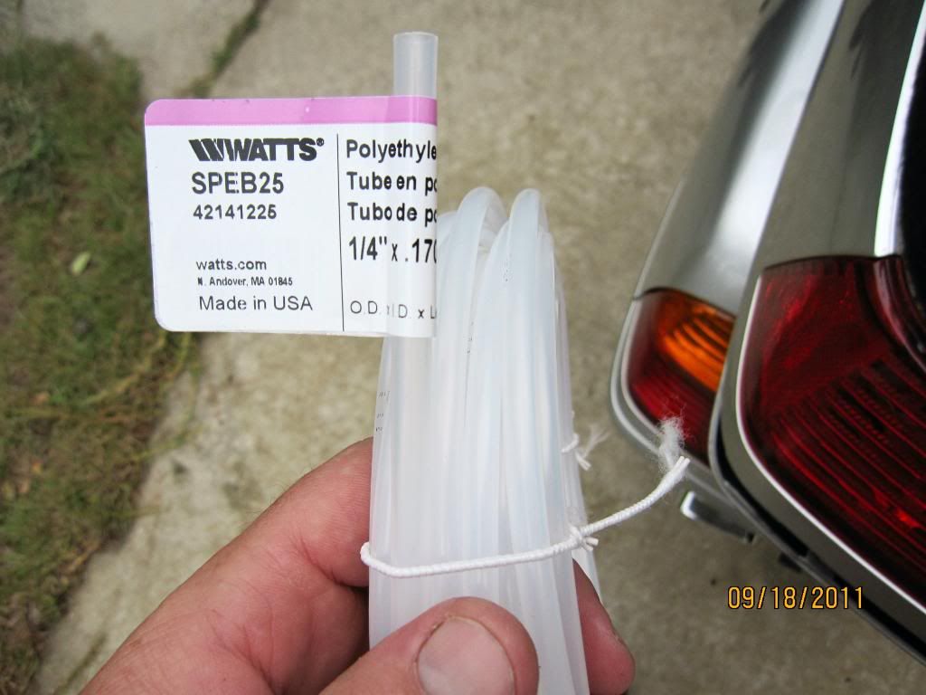

While in the Home Depot I located what I wanted to use for the drain. What I decided to use is Ice maker water line for your refirgerator. Quick connect that way if you need to remove the line one day you can. Less than $6 you can purchase this.
1/4 inch connections
And the line

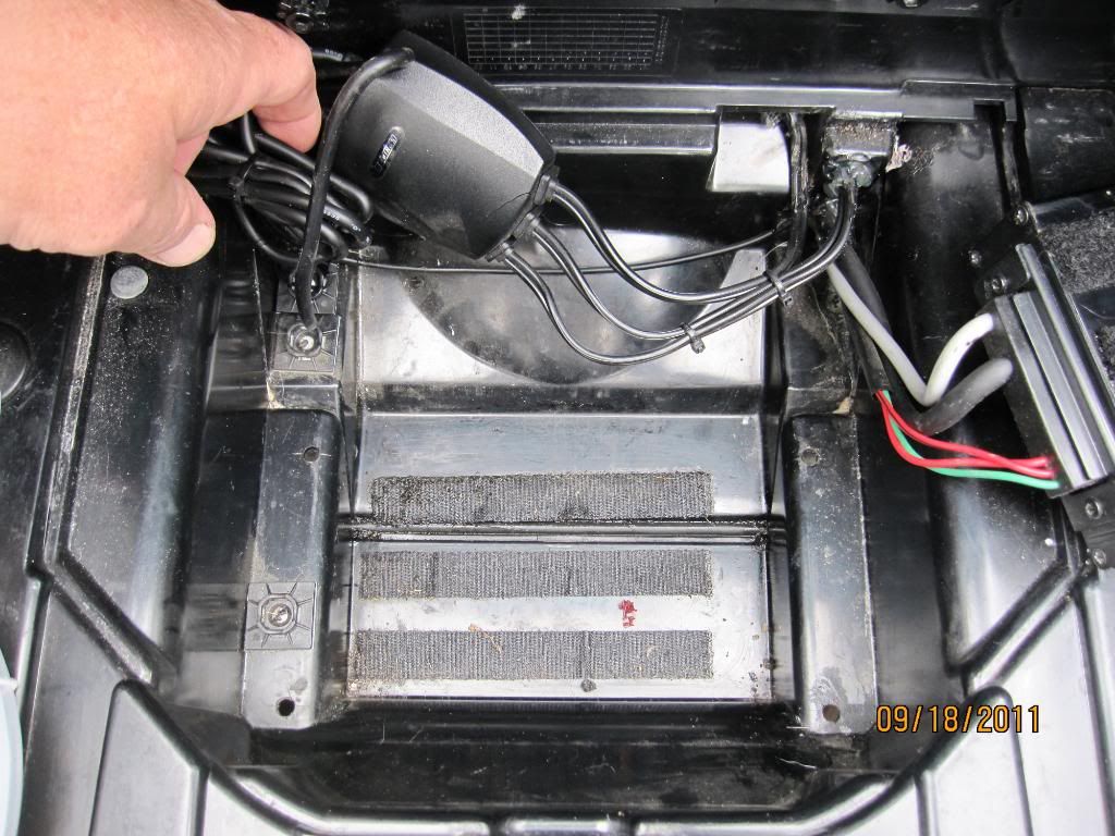

First of all you need to remove the center section where the rear tire is and the CB and CD player if you have one. Then decide where you want to locate the hole for the drain. I have decided that the best place is in the right corner due to the electrical connections in the left.

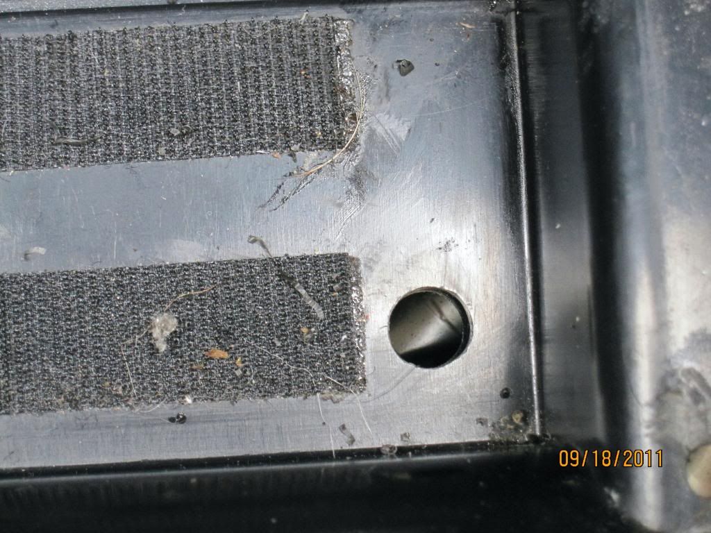

Once you locate the hole you will need a 7/16 drill bit to drill the hole for the male adapter. I happen to have this from a previous project that I will use.
Then drill the hole.

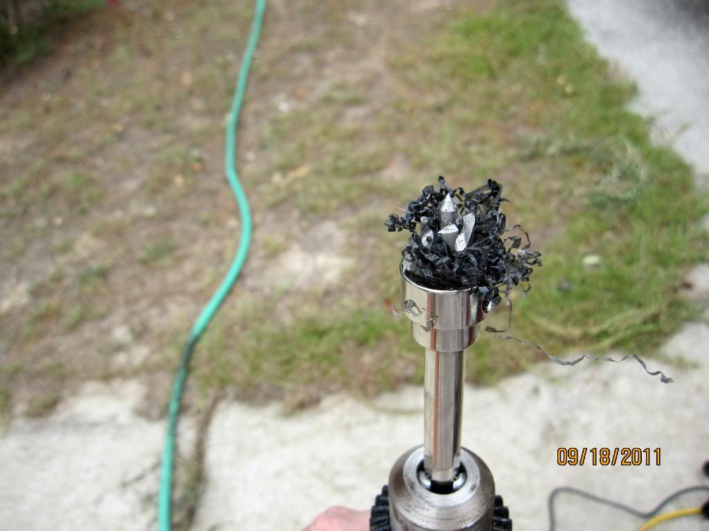

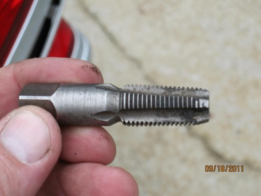

After you have the hole drilled you will need a 1/4 NPT pipe tap. To tap the hole so that the male adapter will thread into.

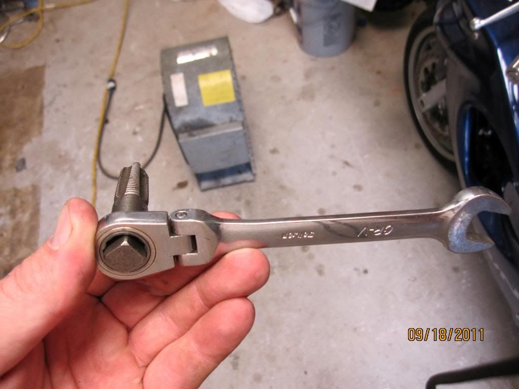

Now this is where it might be a little hard. Since pipe taps are tapered you will need to thread the adapter from the bottom of the trunk. So this means you will have to tap it from the bottom of the trunk. There is very little clearance to put a T handle on the tap. This is what I used. 1/2 rachet wrench on the end of the tap worked great.
Tap the hole. keep in mind that you want to thread the adapter all the way in so you will tap and check the adapter by threading it in.

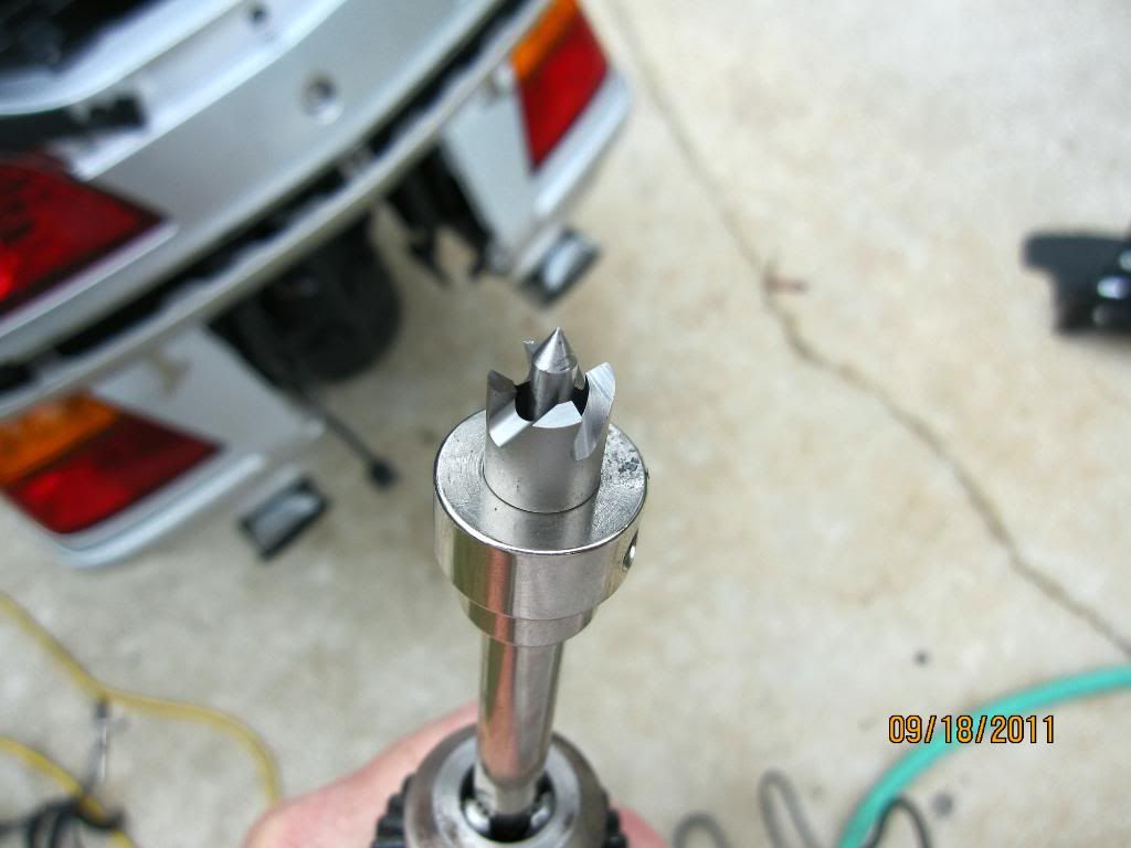

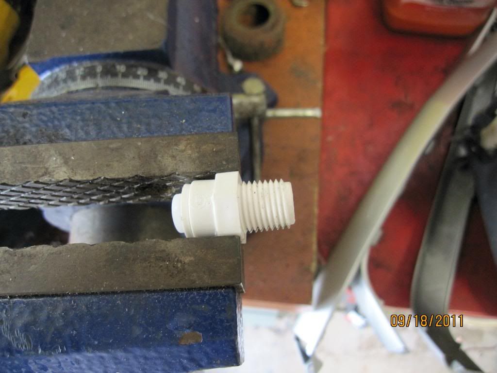

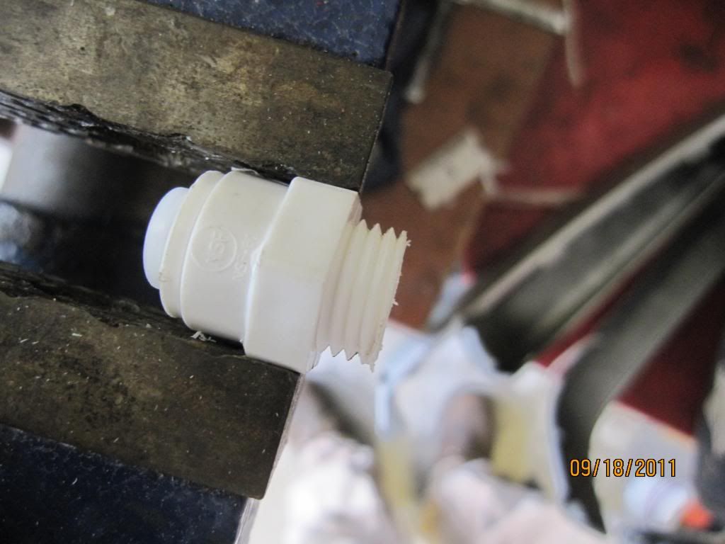

Once you have tapped the hole you will notice that the adapter is sticking up past the bottom of the trunk by as much as 1/2 inch. Yeah I know got that problem worked out also. You will need to mark the adapter with a sharpie where the bottom of the trunk meets the adapter and thread it back out.

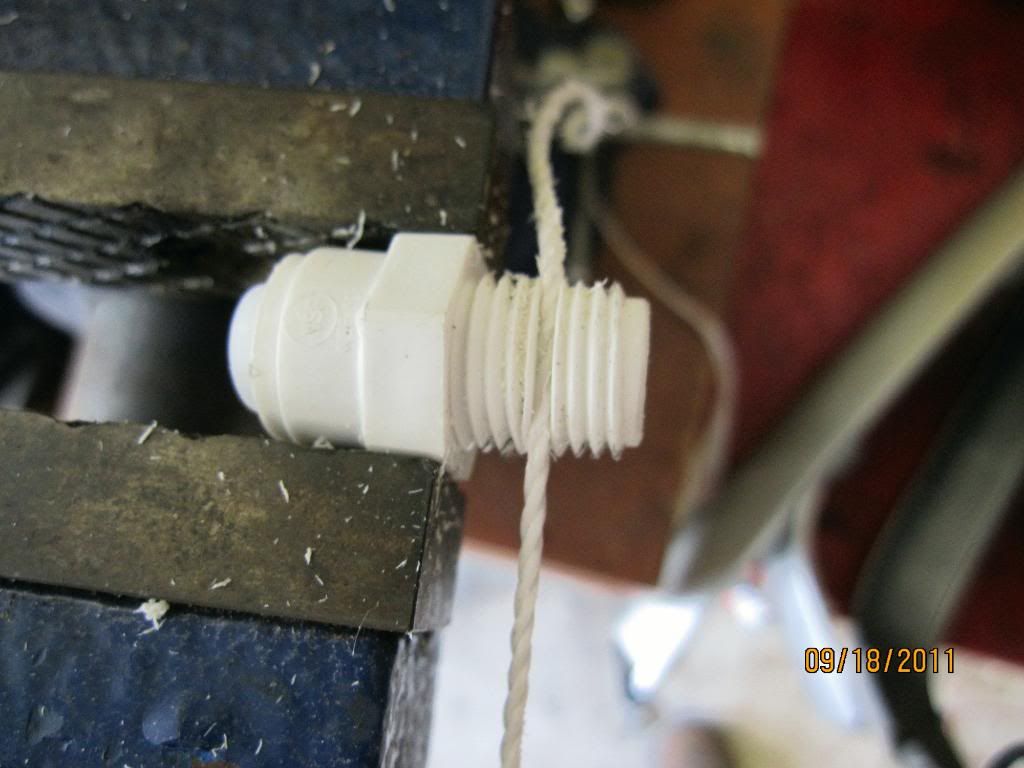

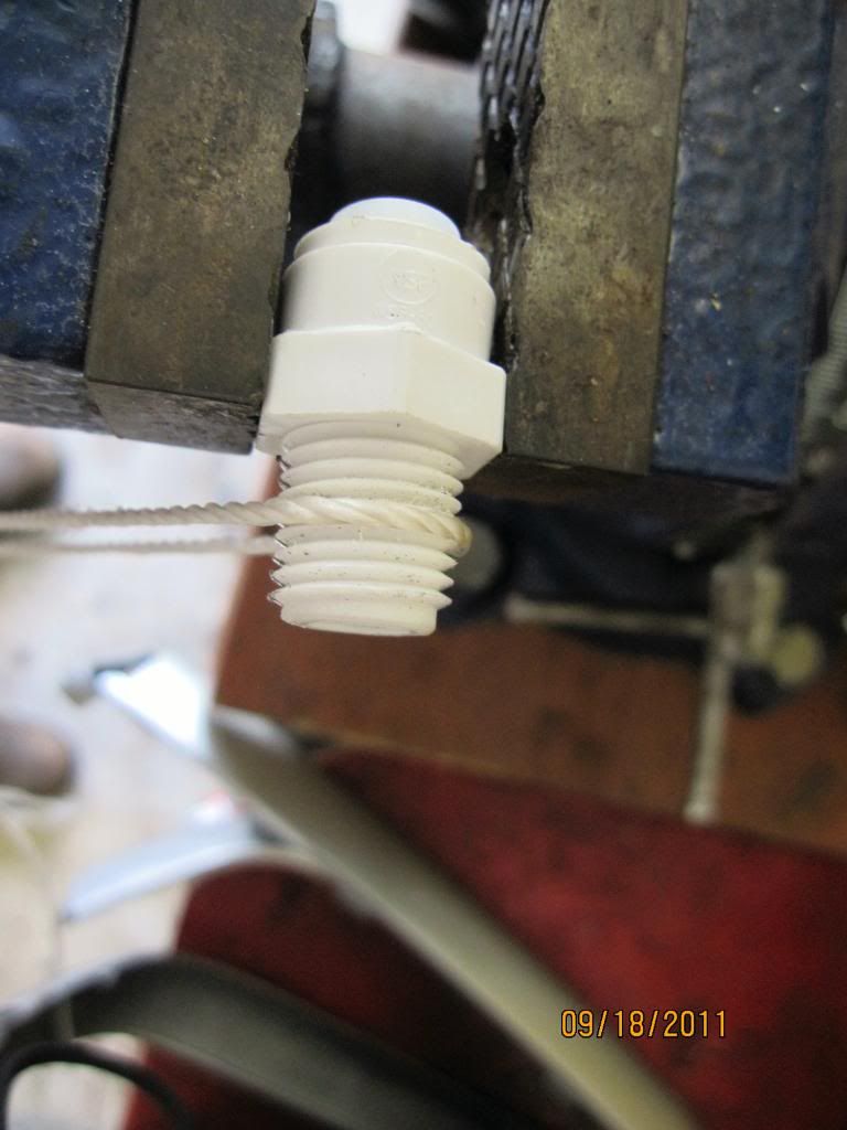

Put the adapter in the vise and get some string. Yes just regular nylon string is all you need.
String is used to cut the adapter flush with the bottom of the trunk.
Just pull it back and fourth in a sawing motion.
It will cut is off smooth. And is a lot easier than trying to hold some kind of saw.

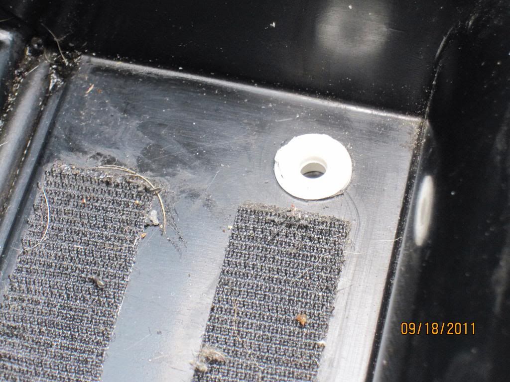

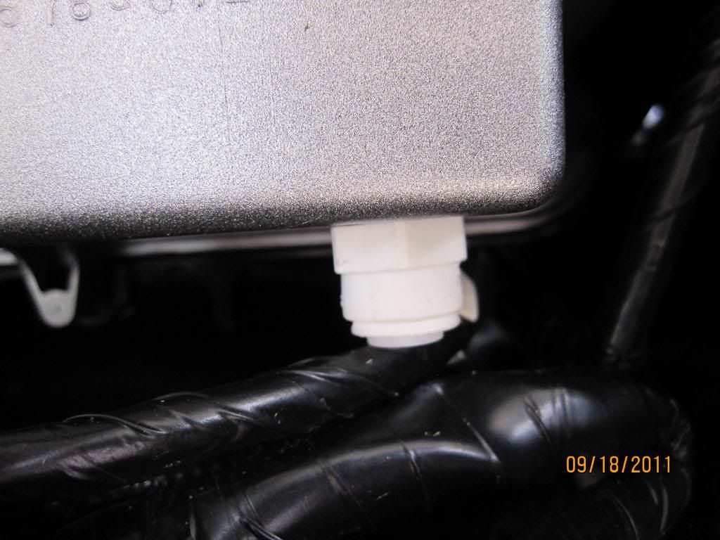

Now thread the adapter back in the trunk using a little silicone on the threads.

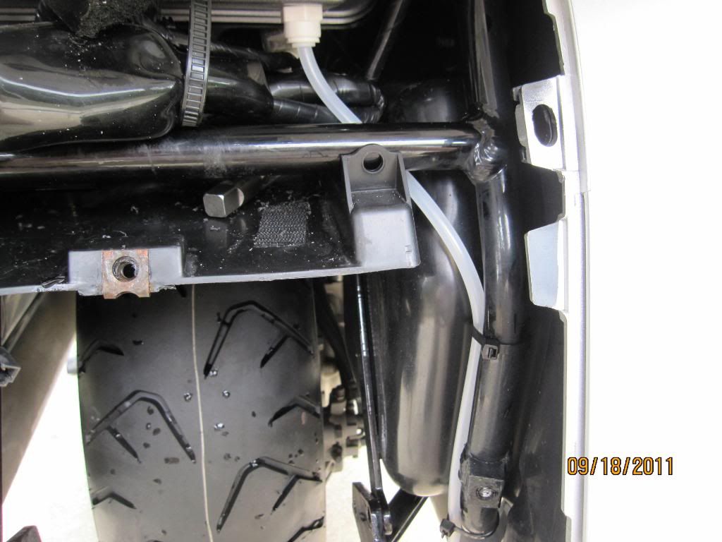

Next you just run you tube and cut to length and strap the line. Your are done!
Total time 30 mins.
Total $$ spent $6

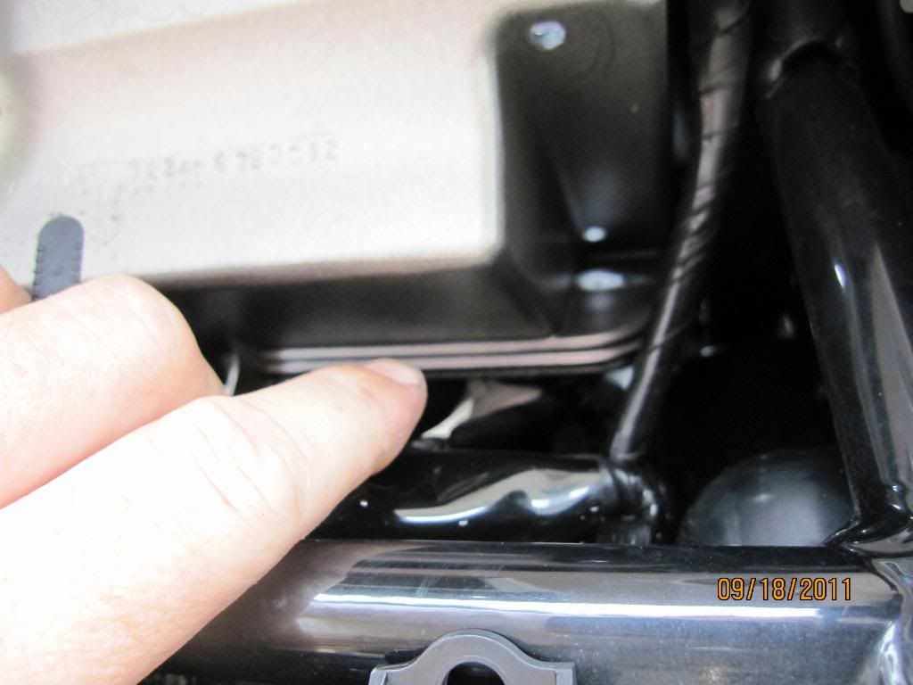

Open the trunk. Put some talc powder in a turkey baster or something and put a small , not too much line of powder on the lower smooth plastic sealing surface of the lower trunk. All the way around .
Now close the trunk lid. Did it seal all the way around??
Yea it did.
