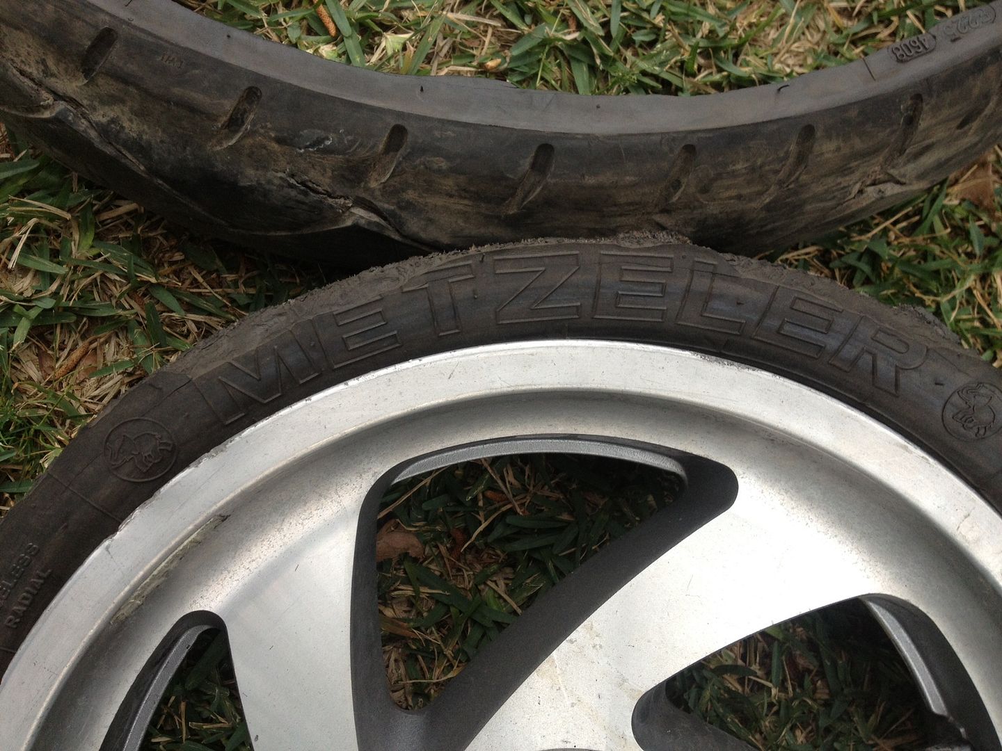

About a week ago, there was a thread on this board titled "Fear of blowout" - http://gl1800riders.com/forums/showthread.php?344210-fear-of-blowout.
One of the responders RonK advised he had experienced a rear tire blow out while riding his new-to-him, Level 1 '06 Goldwing with less than 15K miles back to Colorado.
Yesterday Buckskin and I did some work on RonK's Wing and got to see the tire and rim in question first hand. Here are a couple of pictures....
Buck and I were "HOLY MACKEREL!!!!"
RonK states he checked the tire's pressure and visually checked it during the ride.
The explosion resulted in the tire splitting into the 2 sidewalls and the tread.
It was a pleasure to meet you yesterday Ron!

WOW......That's as scary as it gets..
Thanks for the post.....amazing, so glad he came out okay on that raw deal. I have never seen a tire blow out that way before......has to be a factory defective tire......geezz.

Certainly not against the other tire but if this separated because of a blowout "explosion" it would seem that they tire was defective and I'm guessing defects aren't limited to this brand. (either that or he was running WAY too much pressure in it)
Said another way....if a tire is defective and just going to come apart all at once, I'm not sure if it matters if it's a run-flat or not.
Having said that....I tend to believe the "explosion" on this one was more from the tire separating and not a massive loss of pressure. I wasn't there so I could definitely be wrong but what I think is that he had a leak that occurred sometime after he checked it and didn't realize it and ended up riding it with very low pressure and it eventually built enough heat in the flexing sidewalls to fail and come apart. If my theory is correct, then a RF tire really would have helped here. Although my theory is not what is described as what happened.
I still say if you are going to use a RF, you need to have TPMS or you could go thousands of miles on a tire with no pressure and never know it.
Regardless....I'm glad he's ok....that would have been very scary to ride though.

These pictures are a direct result of NO air pressure in the tire before it's sidewalls decided they had enough from excessive heat and split from the carcass as 2WN suspected.
I have seen this before years ago from another member. Many thought it was photo shopped,but it was not. It too was a Metz. :eek:4:

Yet another visual reminder that the tires most run on the rear of their 1800s are not as safe as most believe.
Like Rocky said, some will know immediately that something is wrong.... but many may not. That's why I tell those who are less experienced to get a TPMS.
