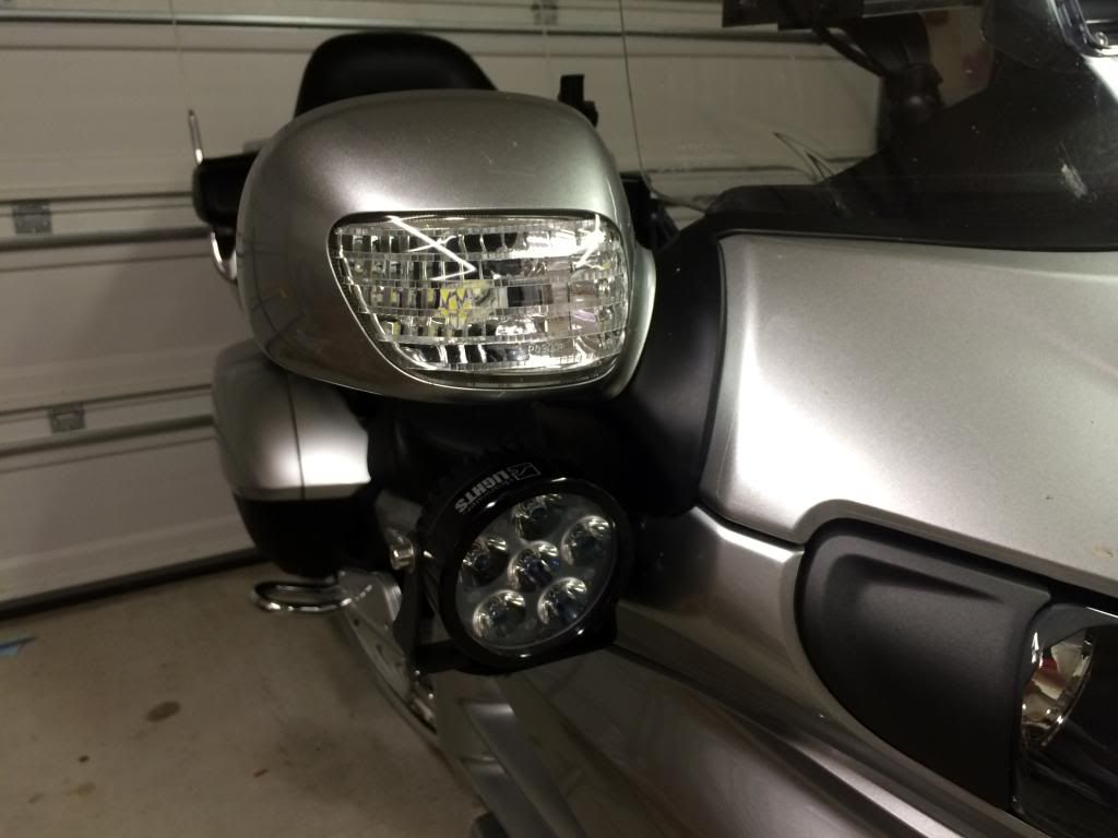

Check out Vision X Optimus lights, I've installed a few sets for friends and they really like them.

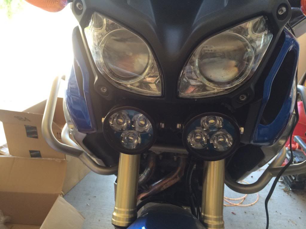

I have Clearwater Krista on my Super Tenere and Erica on the Goldwing.
Clearwater makes a good product but they are expensive. They are American made in CA.
I have had some trouble with my Kristas but Clearwater has stood behind the product with replacements and upgrades. They have also upgraded the design on all units based on some of my issues. Since I have gotten the install sorted they have been trouble free.
The Ericas have been trouble free so far.
The Krista and Erica share the same form factor and controller/switchgear. The newer Ericas pack over 6000 lumens each and draw 5 amps each.
Installation is straight forward but you may have to order extension cables for the pot and the lights depending on the proximity of the controller to the lights/pot (they will send these for free).
There are other LED lights out there (Rigid, Baja Designs, etc.) but I think the build quality of the Clearwater are very good. During use they can turn night into day. With the dimmer set to full low I run them all the time. The full bright condition can only be used with no oncoming traffic.
They come with a lighted on/off switch, a dimming potentiometer, and an interface which allows full high with high beam, full high with horn, and a turn on lead for your switched hot.
The GL1800 brackets are PIAA products and they can be a challenge to install as you are trying to thread the screws through the mirror and bracket at the same time. The brackets did make slight contact with the fairing on my bike but I don't intend to ever remove them as long as I own the bike. You can install the lights under the bracket to accommodate mirror wings if you have them.
I would buy again (and did) but you have to have a real need for this level of aux lighting to be able to justify the expense. I run some LD rallies and running through the night is mandatory. Also on the Tenere I have done some off road work at night (not by plan) and I don't see how you could do it with stock headlights.
