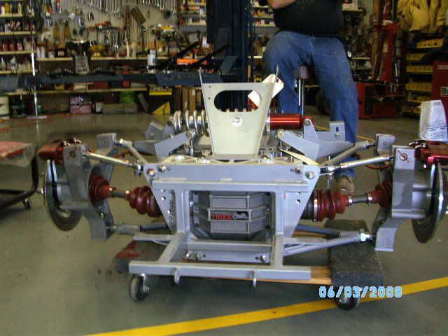

I went by Cowboy Country Sales, Bandera, TX, as they were installing a CSC kit. I had told Ken Schreiber call me when he took it out of the crate so I could look at it. I was impressed. These pics show the standard shock that comes with the kit. Ken had not yet put on the adjustable shock. I am not a pro, but it looked very well built, strong, well machined, with the killer brake upgrade. Overall, a very nice unit. The pics were taken today, 1-18-09, my cameras battery ran down so I guess it reset the date. Anyway, a fun and informative day.

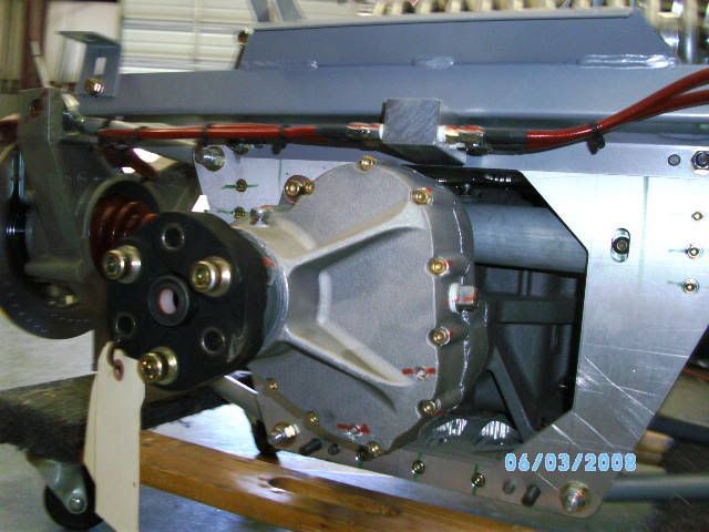

Thanks for the pixs George. Wonder what all the tags on the dif are for.

The tags were on the differential when taken out of the crate...part numbers and other codes. No, I can't justify a new trike. Mine runs very well with no problems. I have it adjusted like I want it and have no reason to trade it. I get attached to my toys...one of my greatest loves is my Kabota tractor...;) had it over 19 years and it runs like new. This CSC equipment is the real deal however.

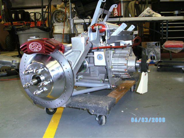

Ben, I don't know why it is mounted on top. I do know the red caliper shows through the wheel and looks good. Other than that, no idea.

That was my thought too! "...the red caliper shows through the wheel and looks good." <g> On the other hand, placing the caliper on top raises the center of gravity...

Good photos. Interesting design. I don't recall ever seen calipers mounted on top of the rotors. I wonder if there's a reason for putting them there?
I don't know the reason the calipers are on top but it sure makes it easy to change pads. You just lift the old ones out and drop the new ones in place. As to raising the center of gravity, considering how well the Cobra corners, I don't think it has much of an effect.

Calipers on top make bleeding air from the system more proficient (I mean) efficient :eek:4: .......... and I'm sure it was done to enhance the appearance though the wheel. Can you imagine trying to read CSC sideways? Either way they stop just fine. Love that nickel plated drilled rotor too!

I'm confused. :shrug: If the wing has the drive (removed) on the right when sitting in the seat, how does that rear bolt on ??? It looks to me the drive is centered on the setup.
I would like to see pics of the unit being installed. I'm getting to the point in life, the trike is just around the corner and I like the CSC style ;).

When installed the transfer box that you see is actually to the right of center just a few degrees off from the driveshaft output on the bike. The center of the unit is where the brake block above the transfer case is. Makes for a smooth transfer of power. CSC did a nice job designing it, it works great!
