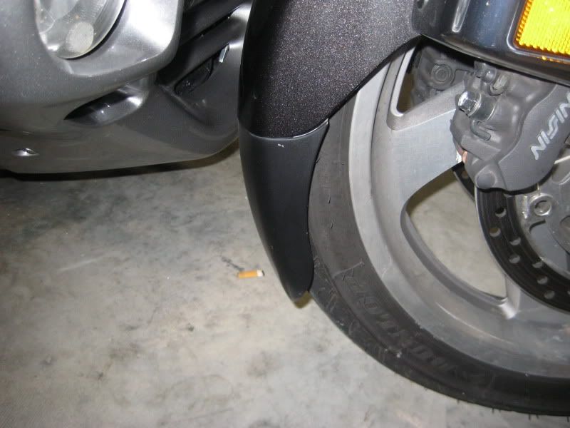

What was I thinking? Everyone knows you can't live without a suspension upgrade. This was my 4th personal Wing to recieve the full Traxxion suite.
Rear shock almost falls in by itself.
All Balls
Modified the left fork leg as required.
Prime and reassemble.
While at it, balanced the wheel and then installed Centramatics. Fork brace and rock gaurd.
Added some REG risers (run them on all my Wings) after torqueing the All Balls tapered neck bearings to 12 ft/lbs!!! What???
For me and my money, the Traxxion upgrade is at the top of the list on best mods.
