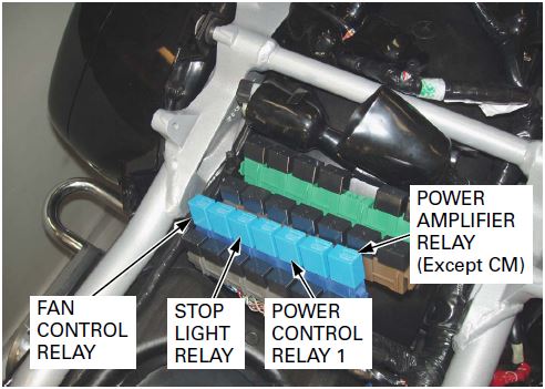

OK, have you checked the basics yet...the 40 amp fuse that's just for the main amp, tried swapping it's power relay under the seat, checked for power on the brown wires at the amplifier's connector?
I would check the connector back there for power first, if it's there, you will know the fuse and relay are good.
Relay
Is a relay something that I should carry as a spare. See so many threads on this board..... "check the relay" ..... Don't know if local stealer would have one in stock and it seems that most relays if they go bad, will put the bike down for the count.
You could, they don't fail very often, but they can and do fail. Most dealers don't carry much of anything, but they are glad to order them for you at their marked up price. :? I don't carry any extras, because you are already carrying spares, sort of. If you suspect a failure, there's usually another one on the bike for a different system that can be substituted until you find a new one. The power amp's power relay would be the exception as well as the 2 starter relays, because of their current ratings.

The most comon relay on the Wing is the 4 pin 20amp, P/N 38501-MCA-A61
OK, just figured out the amp's power relay is the same as a couple of others and isn't as special as I thought and is swappable with a whole row of others in the bank.
If it's the same as the heat relay, it's the part # I posted above.
It looks to be the same as the brake light relay and any of those in the second row:
See less See more
