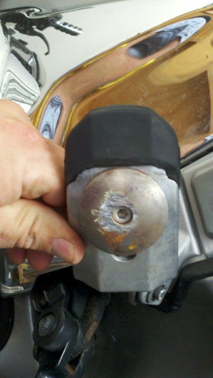

It may be too little too late. As my lines have improved, I drag less peg, or could I be slowing down?
These bolt on using the same hole the acorn nut used.

What are those things?
They wouldn't last to long on my bike if I was in the mood to lay a few sparks on the ground.The allen head bolt head would be gone in short order.lol
I got these on my pegs.

what are they and where did you get them?
1,139 Posts
Big Galoot how's it going? It looks to me that they are 3/8 in thick so that I would think would make you drag the pegs more.:shrug: Oh by the way mine are getting there too, not as bad as yours but I only have 13500 mile on my new 1800 so I have to do something in the near futurel.:eek:4:

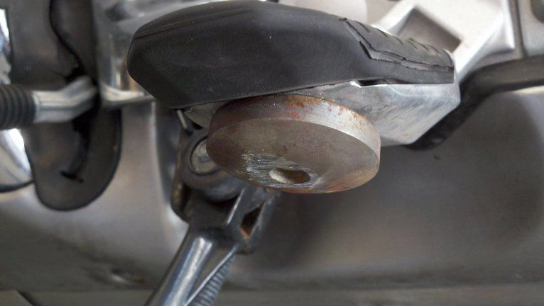

I had them made to experiment with. The are made from steel. The outside diameter is overkill. Need to address that (design change). I sent my extra set of pegs to a buddy with a machine shop. Call these Gen 1!
So far I have only ground them cutting hard exiting a parking lots.
Typically when I was leaned way over, I had to pick my foot up to keep from grinding the edge of my boot.
Call them a work in progress.

I had them made to experiment with. The are made from steel. The outside diameter is overkill. Ned to address that (design change).
Au contrair - make them smaller and you may be more likely to get caught in road surface imprefections. I would keep them that size. You selling any?

Titanium make a white spark vs yellow from steel.When we first made up some tips we found steel to soft and wore to fast.
The tips I posted in the picture above are Titnaium.
I got a friend that machines them with a 8mm thread.you need to drill the acorn nut on the bottom of the stock pegs from 6mm to 8mm.
He sells his 1/2 x 3/4 tips for $15 a set plus shipping.
I use 5/8 x 1" rod for my tips.
DJ sells his floorboard savers through Traxxion (under Goldwing accessories) they are steel.

But I am doing a couple of final checks on a direct bolt on Titanium peg saver similar to what you are using. Can't touch your price but mine does not require any mods to the pegs. Mine are also 3/4" not 5/8"
Does your friend want to make more or just a project for you?
Doug.Anything is possible.I'll ask him.
The issue with not touching the stock 6 mm threaded hold in the stock peg is when he made his 1/2 tips with the 6mm,they snapped off when dragging.he lost a couple of them.
He found that when he made the threaded shank with 8mm threads they were fine.
I was looking last night at titanium prices from the guy in LA that I buy my rods from and Titanium has doubled in price since the last 22 sets I had made up a year ago.Metal prices fluctuates just like wood at home depot.So buying when the prices are much lower for titanium is the key.
