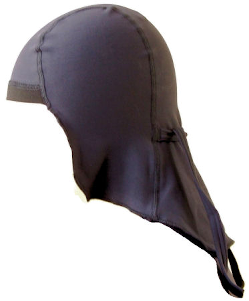

3,963 Posts
When putting the helmet on, it's OK now.
After the helmet is ON, it is alright now.
Removing the helmet needs to take a different route. I need to pull the helmet to the side, one side one pull and do it a couple of times while I shifted the helmet upwards.
A head skin may also help you, but you have to find one that covers your ears. That way your ears don't get caught on the speakers whether donning or doffing the helmet.
