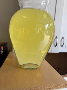

Just curious, has anyone tested for water in the gas tank?
I can't tell you, I haven't dealer was told the code was for an ISG the waited for a part to test. They got that and it was not the ISG. After a month I decided to pull it out of there. Is there something I can from AutoZone or somewhere to test? I will say once it started and ran for 10 minutes it ran like it did the two days I had it.
That's great news that you got a start out if it. That eliminates a lot of the expensive items.
Contaminated fuel is a possibility. I don't know how to test for it but the cheapest option would be to drain the tank, clean it and refill. There is no external filter, just the sock filter in the fuel pump.

I would siphon a big jar or glass of gas out from the bottom of the tank and let it sit for a while to see if you can see any water separate out. …. It’s easy to put that question to bed. Water is heavier than gas and will collect at the bottom of the tank

Another option might be to just siphon all the gas out into a 5 gallon can and replace it with fresh gas. That way you know what is in there.
Yup. Hopefully after it settled, you would be able to see if there was any water contamination. If you had the ability to freeze the container, you would find out for sure.

@Fred H. @Zee Fifty So I think I got all the gas out. My wife is unhappy I used several of her large flower vases... LOL. They all look like this one which is the very first one. I went a got a siphon this am. Now I am headed to buy fresh 87 gas.
