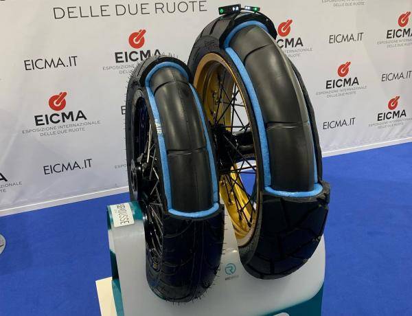

As to the why not - limited market, too many types of bikes. Almost a zero return on investment. There have been attempts over the years, read this article.
Now a new company has come out with a quasi-run-flat, not a true run-flat and will never be made for a large touring bike like the wing.
